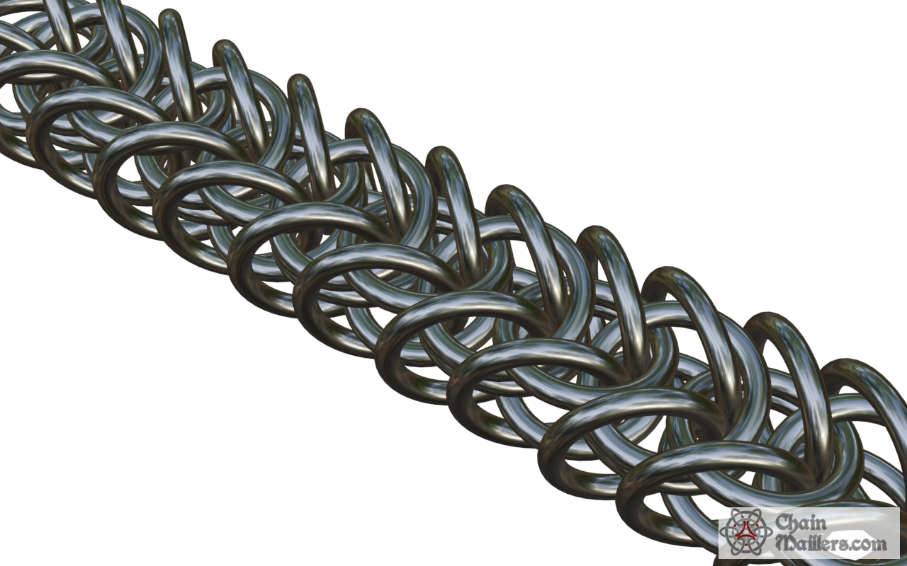

Very interesting weave, I teach in the local high shool, how difficult and is there a tutorial.
Difficulty is subjective, but personally, I would consider this no harder than Box.
  1. Take two 2 in 1 chains, and lay them, mirrored, on top of each other
  2. Edge them through the eyes on both sides.
Side note, if you layer the two 2 in 1 chains, you get Zymolisis.
As per the entry, in the area of 5.0 is a good general AR. Just to let you know though, the edge rings in this weave can freely swivel. In other words, it wont necessarily stay all neat and pretty like in the render ;)
