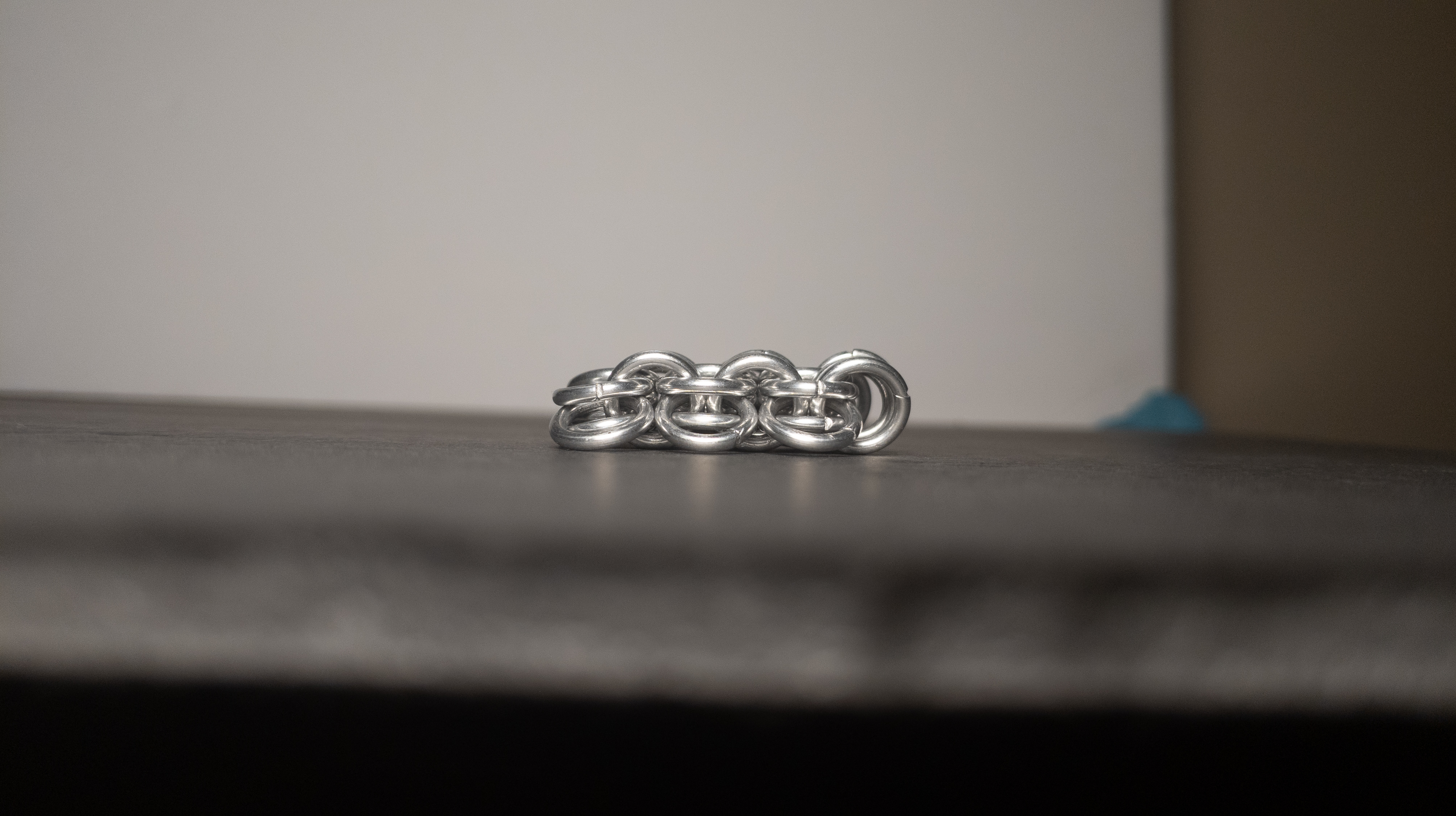

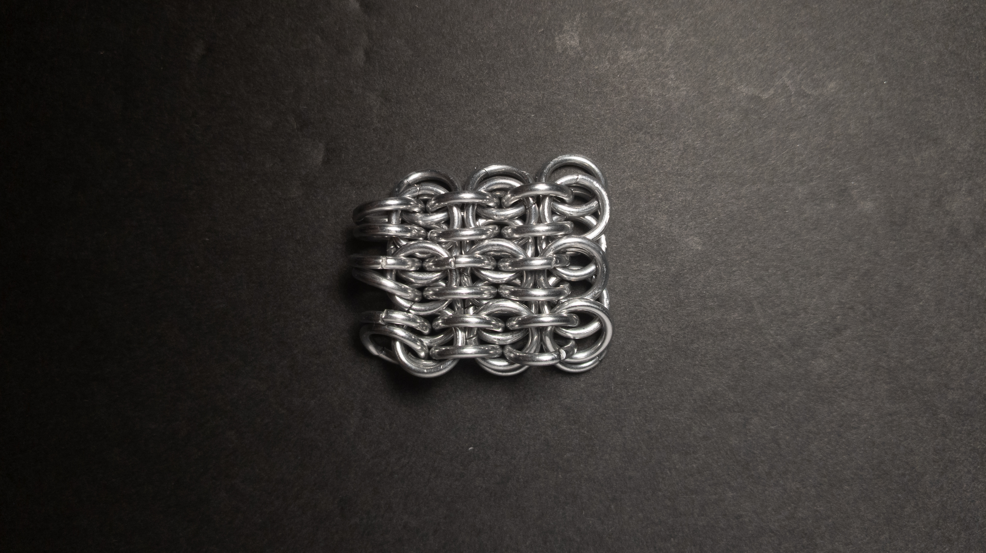

Does the updated version in these images look closer to meeting the definition of a band form for the back to work weave?
Yes, although this could be considered 2 things, a sheet patch or an unterminated band. Back to work is, in its base form, a terminated band to begin with. Three more rings continuing the pattern at the bottom of that would make it a terminated band.
I would disagree, unless you have a very loose definition of band.
As far as I'm concerned (and therefore CCT), the simplest form of unterminated band is "European 2 in 1".
Edited to add: moaatt moaatt I should also add, (thanks Karpeth Karpeth ;) ) what you have in the picture would be a weave patch, it would need to either be extended further and/or expanded further to actually "become" a band.

moaatt
I did originally create this with the idea of being a sheet. Would the most recent version be considered a sufficient example to be recorded as sheet version of the back to work weave?
Karpeth Karpeth I am curious to know how you would classify this based on how you defined your terms. If you could give me your view on it I would appreciate that.
It’s a sheet.
