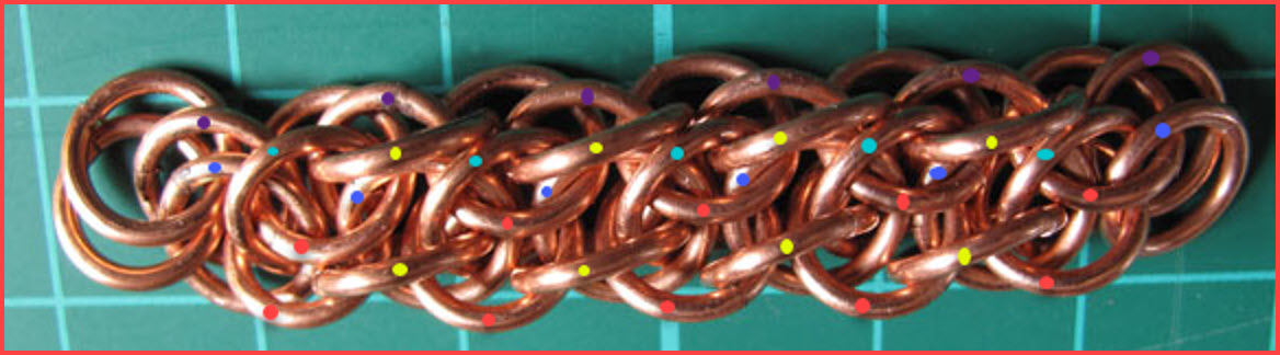

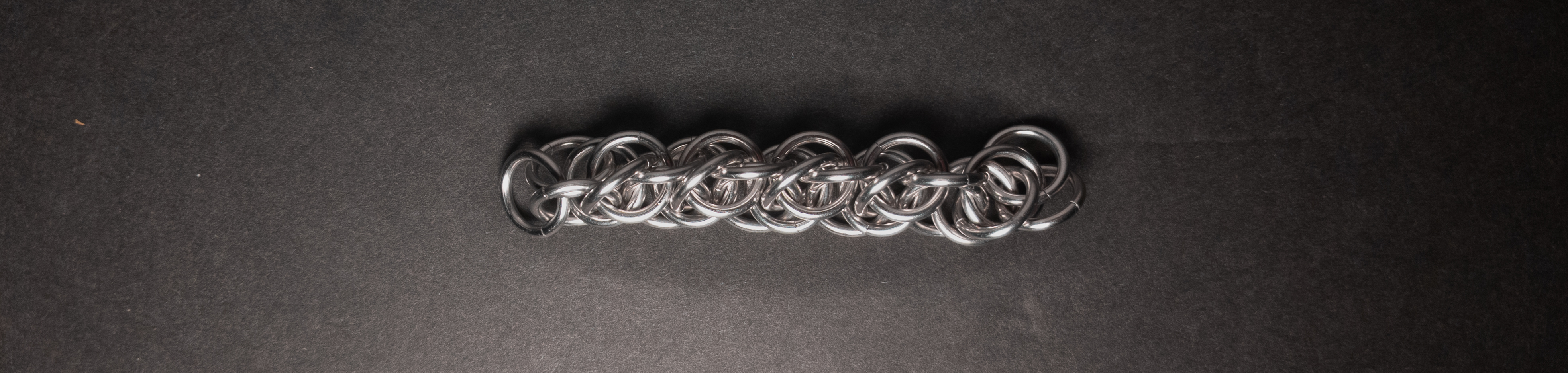

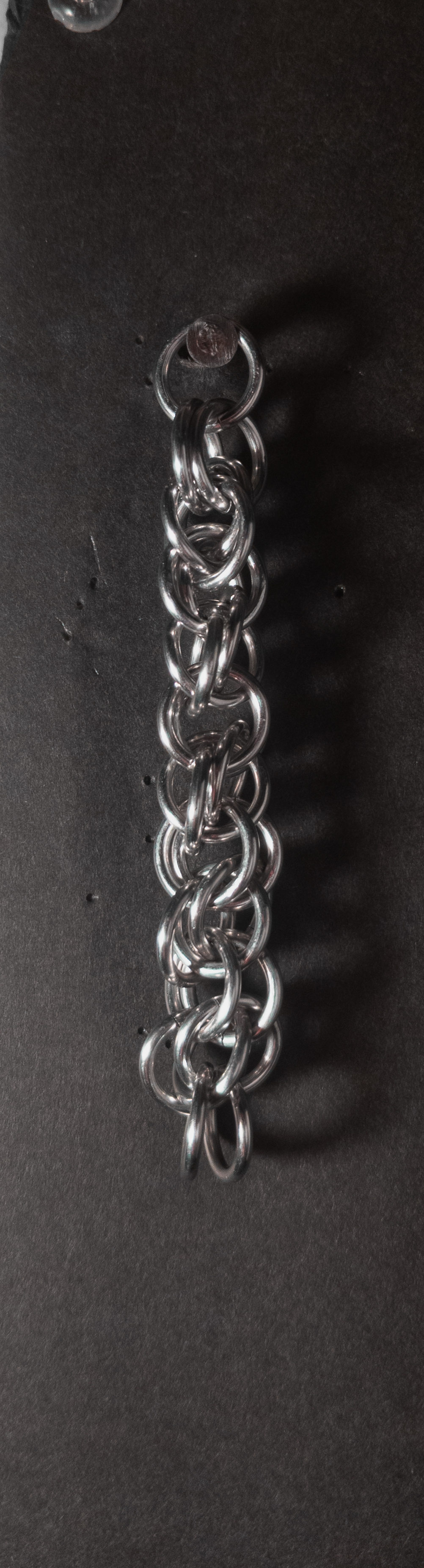

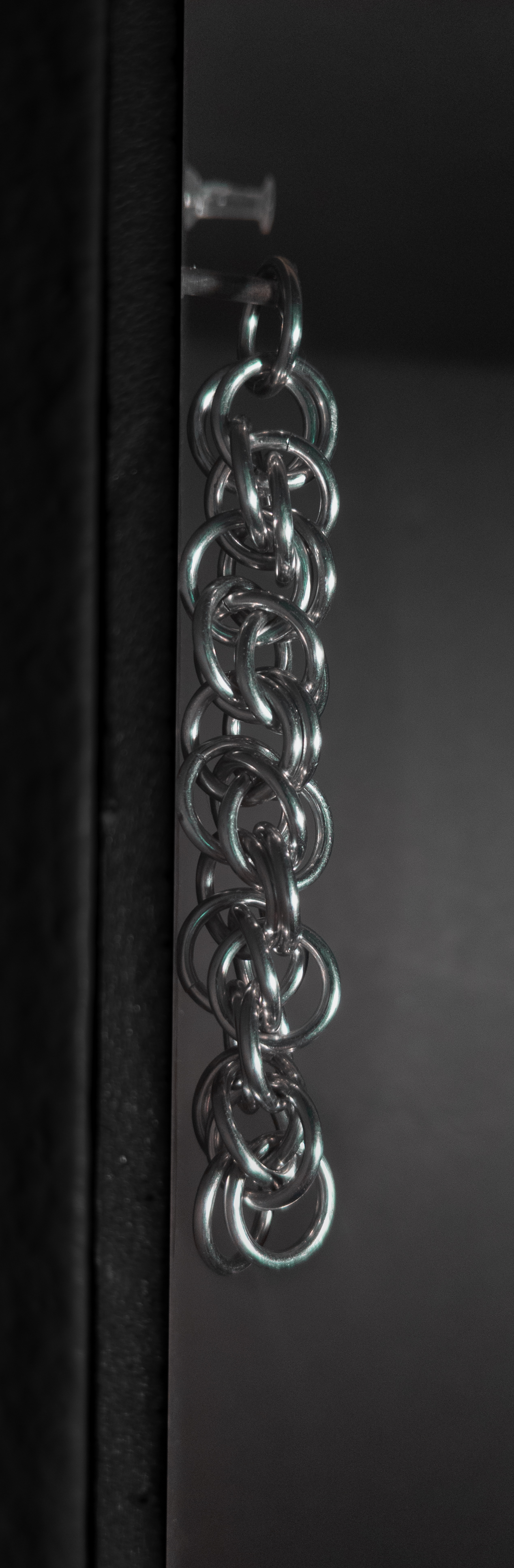

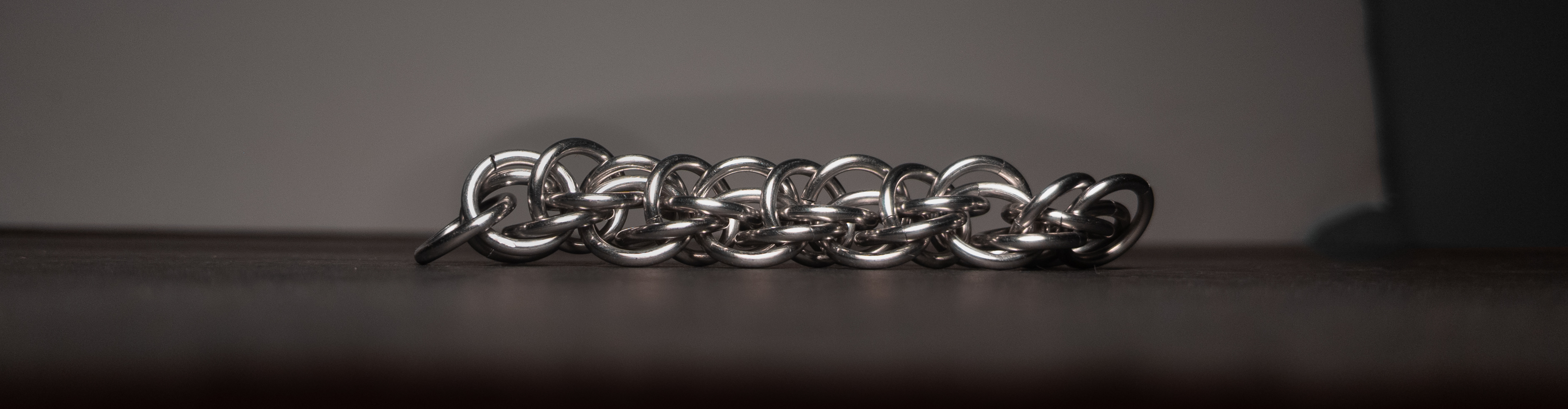

Hello everyone. I was recently trying to make Dolphin and I made a mistake. From what I can tell my primary mistake was that I neglected to have the horizontal rings between each pair of vertical rings causing each pair of vertical rings to have two vertical rings around the eye go through them. I was wondering if this is already classified as a weave or if I have stumbled upon a new weave.

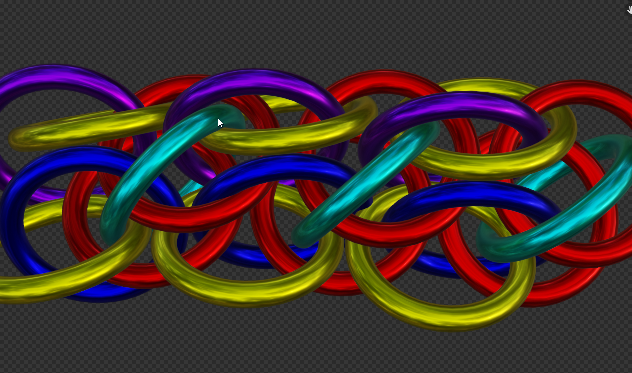

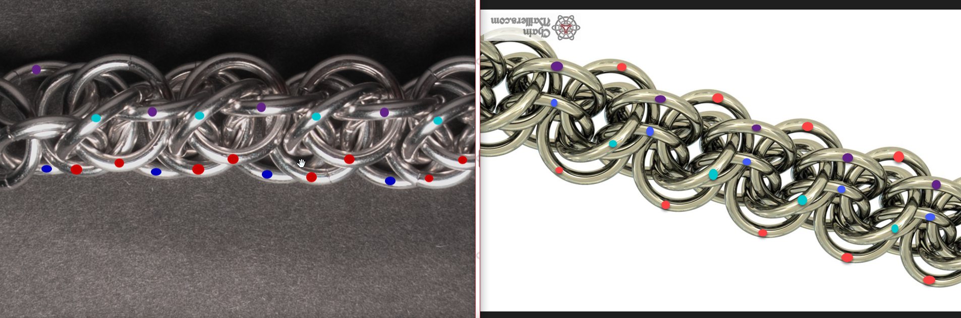

This definitely has the potential to be something different, it is NOT the same as dolphin

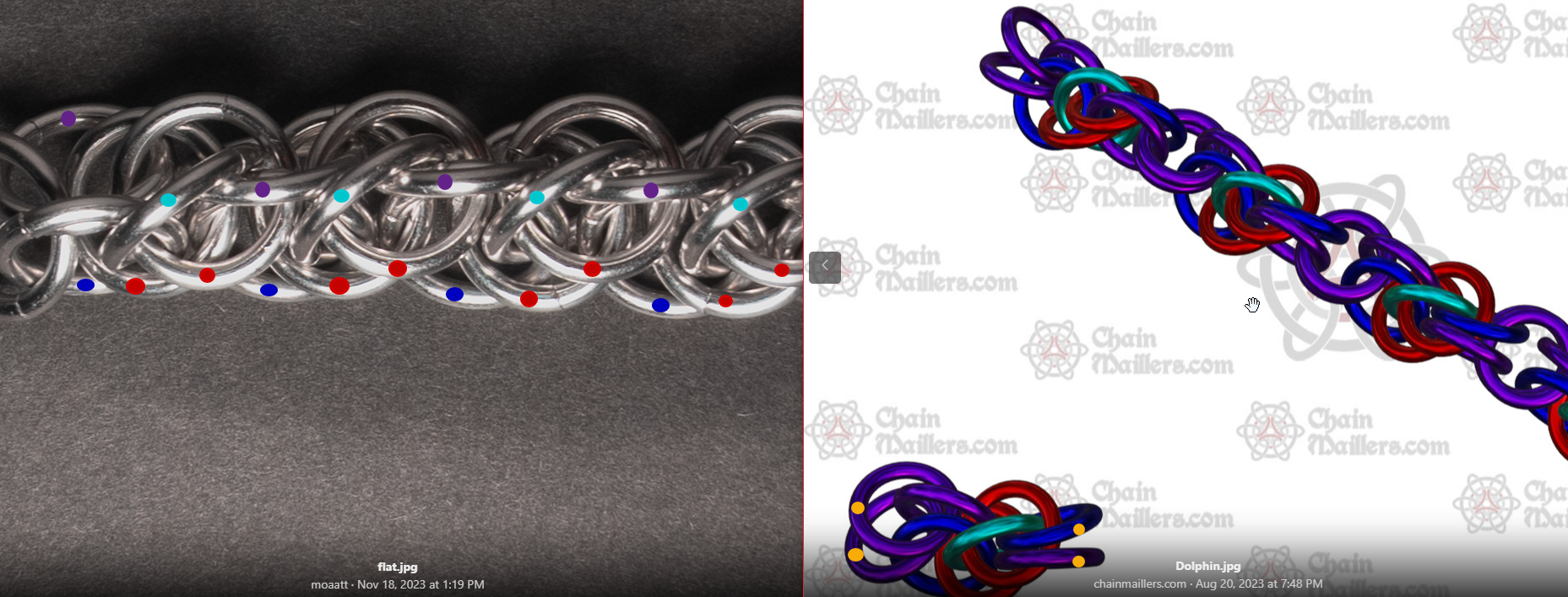

Looking at the maillesplosion, a weave cell of dolphin is 8 rings. What you made is only 5 rings per weave cell. The rings marked with yellow/orange (whatever that color is ;) ) are not present in your picture. Now, as to whether this is new is another story, It would at the very least have to be checked against any "rhino" weaves, as well as ZiLi's (may he rest in peace) many rover variations.

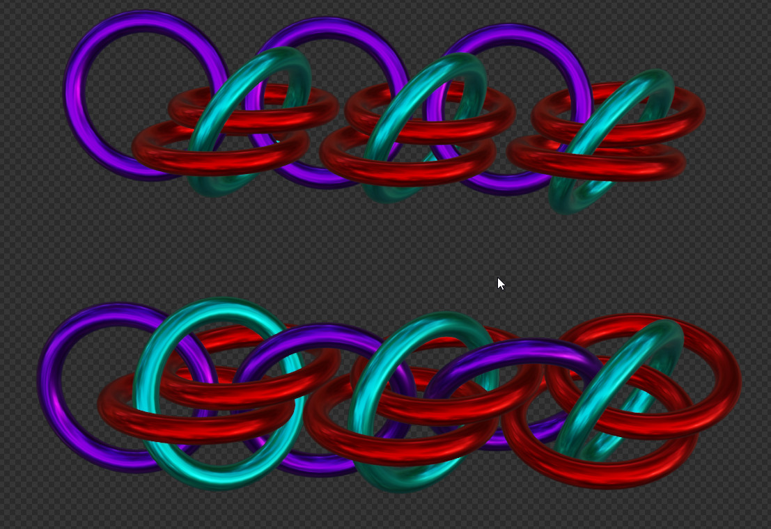

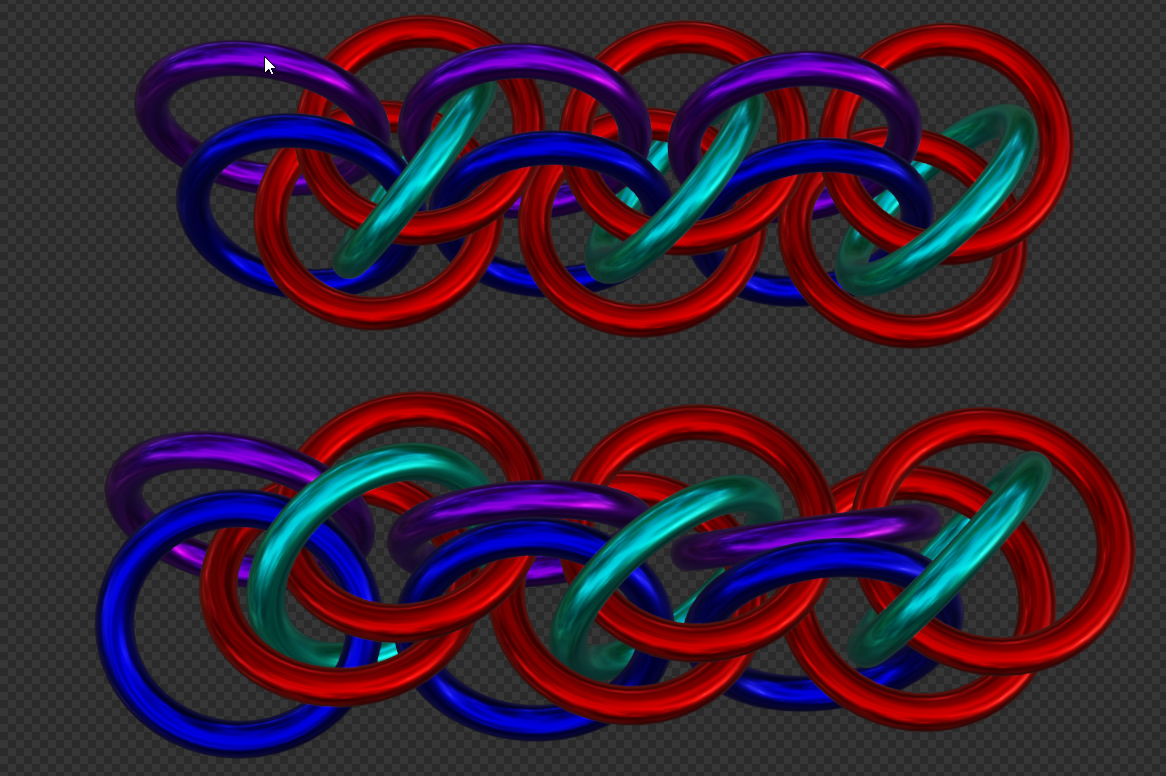

First of all, I want to note that I had to turn the render over for Rover in this screenshot so it will match the orientation of the weave in moaatt moaatt 's photo.
It looks like the purple rings are connecting to the cyan ring differently which forces the reinforced (cyan) and the red rings to turn at a greater angle.

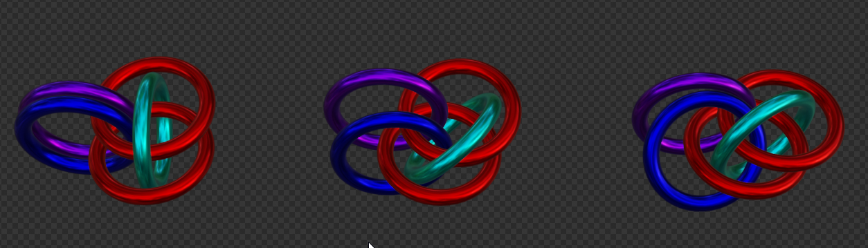

Base Cell, Rover Cell, Moaatt Cell: (AR 5.5 for both)
Rover (Top), Moaatt (Bottom)

The difference is perhaps better seen at a different angle and without the blue rings (since they have the same connections in both). :D Look at the positioning of the purple rings; rover on top, yours on the bottom.
The difference between the two is how the purple rings go through the cyan rings. :)
So this is basically a reversed rover? Then I know what to look for at MAIL.
Huh.

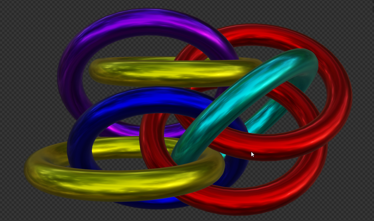

If you remove Purple middle and yellow middle, you are att this new, tho?
Do you mean blue middle and yellow middle?
Either way (purple, yellow or blue, yellow) it's not the same because the yellows only go through 2 reds. Blue and purple go through 4
I See.
Then MAIL should be seen as combed.
That was the closest thing on MAIL.
Thank you, this does make the difference quite clear.
